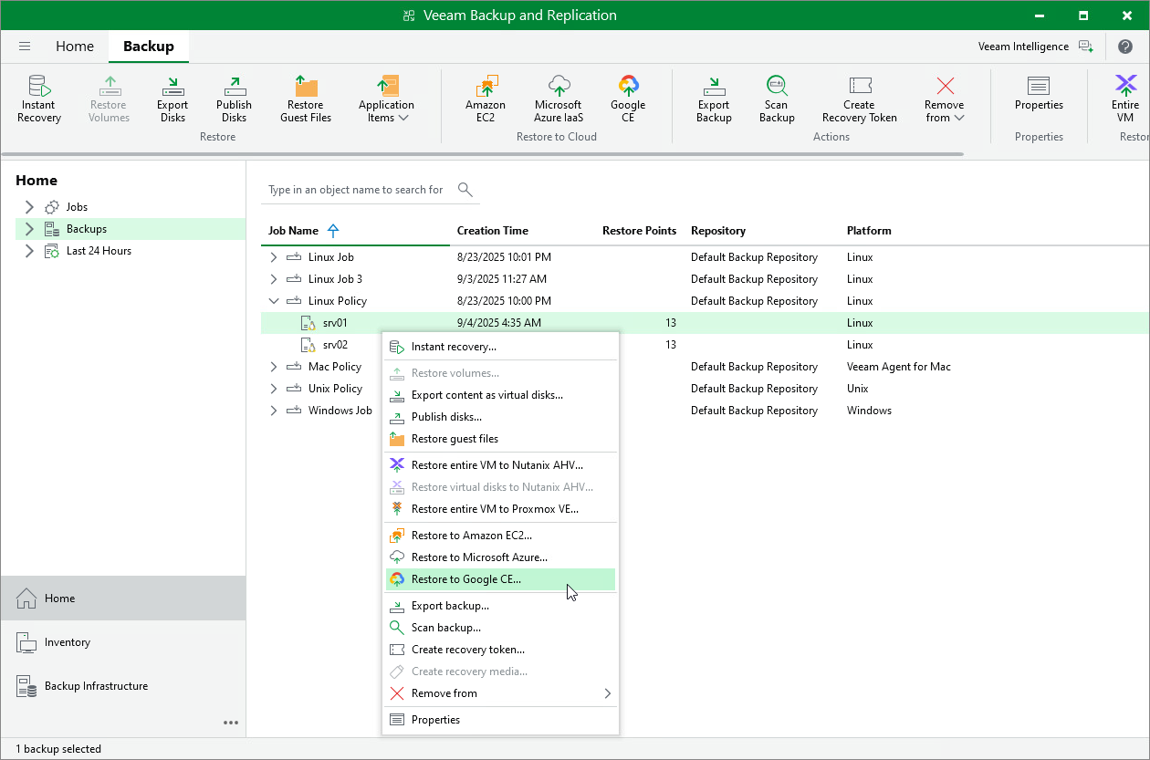

Restore to Google Compute Engine
The procedure of restore to Google Compute Engine from a Veeam Agent backup practically does not differ from the same procedure for a VM backup. To learn more about restore to Google Compute Engine, see Restoring to Google Compute Engine.
