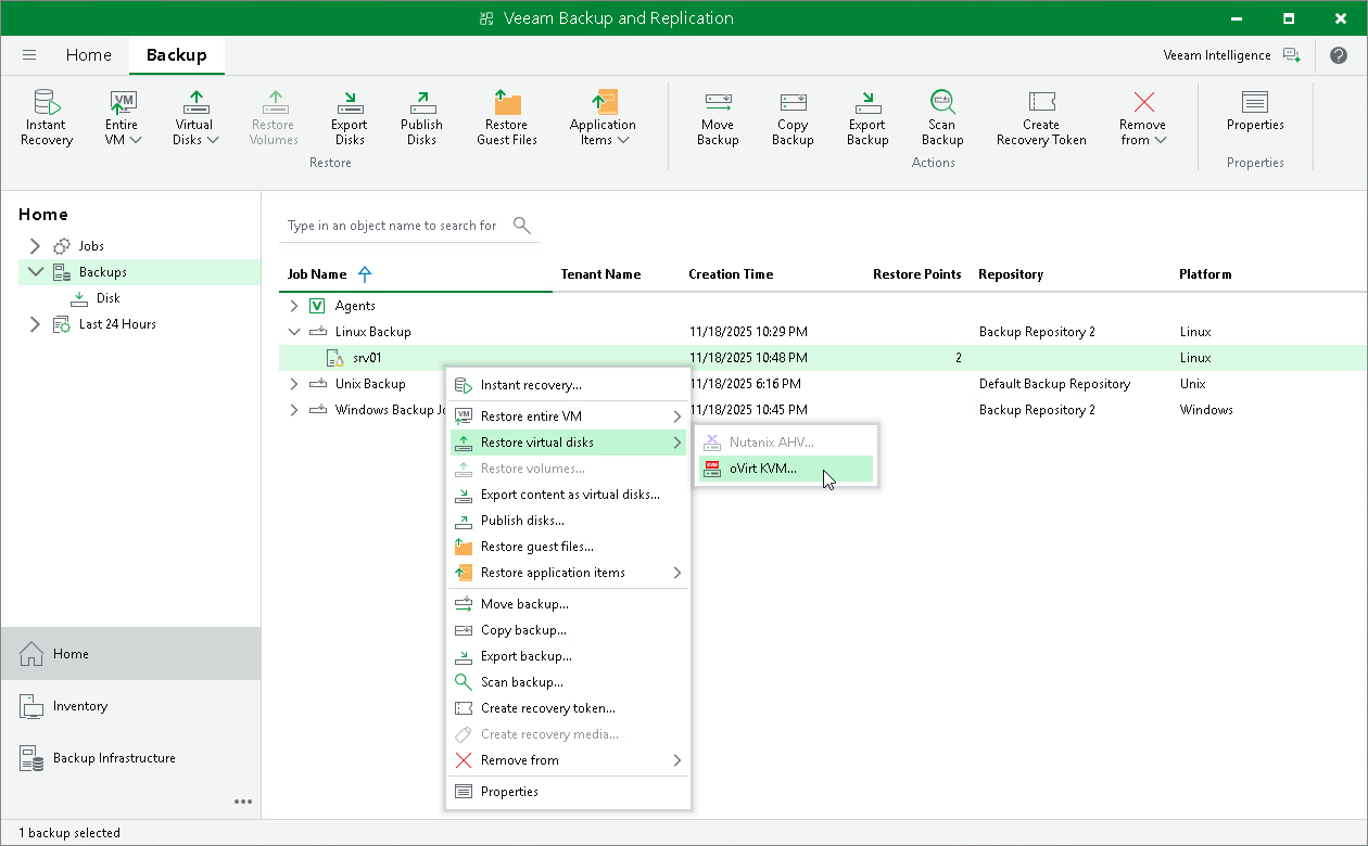

You can use the Veeam Backup & Replication console to restore disks from a Veeam Agent computer backup to an oVirt KVM VM in your virtualization environment.
If you restore disks to an oVirt KVM VM, consider the following:

Restore to oVirt KVM VM
The procedure of restoring disks to an oVirt KVM VM for a Veeam Agent computer practically does not differ from the same procedure for a VM. To learn more, see Performing Disk Restore.
Restore Disk from Veeam Agent Backup to oVirt KVM
