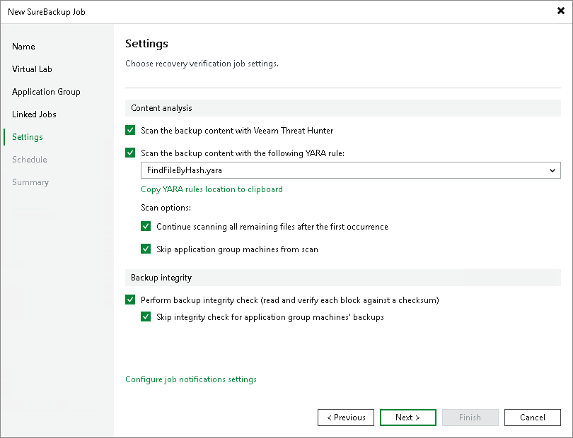

Creating SureBackup Job
  1. At the Settings step of the wizard, specify additional settings for the SureBackup job. To learn more, see Specify Additional Job Settings.

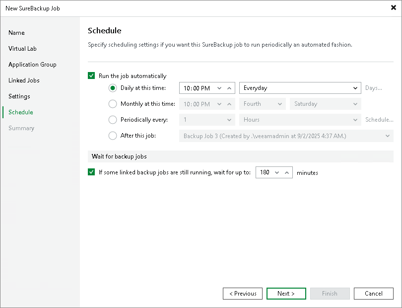

  1. At the Schedule step of the wizard, select the Run the job automatically check box and specify time and days the job must start. By default, the SureBackup job starts daily at 10:00 PM.
