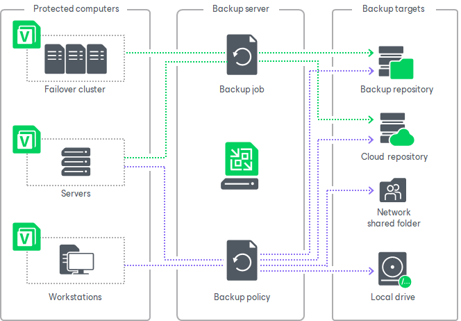

To back up data of your protected computers, you must configure a Veeam Agent backup job. The Veeam Agent backup job defines what data to back up, how, where and when to back up data. In Veeam Backup & Replication, you can create Veeam Agent backup jobs of the following types:
  • Backup job
The backup job that processes Veeam Agent computers runs on the backup server in the similar way as a regular job for VM data backup. The backup job is intended for protected computers that have permanent connection to the backup server, such as standalone servers and failover clusters. You can use the backup job to create Veeam Agent backups in a backup repository or cloud repository.
In Veeam Backup & Replication, the backup job of this type is also referred to as the Veeam Agent backup job managed by the backup server.
To learn more, see Backup Job.
  • Backup policy
The backup policy describes configuration of individual Veeam Agent backup jobs that run on protected computers. Veeam Backup & Replication uses the backup policy as a saved template and applies settings from the backup policy to Veeam Agents that run on computers specified in the backup policy. The backup policy is intended for protected computers that may have limited connection to the backup server, such as workstations, laptops and so on. You can choose to create Veeam Agent backups in a backup repository, cloud repository, network shared folder or on a local storage of a protected computer.
Veeam Agent computers that are members of a protection group for pre-installed Veeam Agents can be processed only by backup policies. To learn more about protection group for pre-installed Veeam Agents, see Protection Group Types.
In Veeam Backup & Replication, the backup policy is also referred to as the Veeam Agent backup job managed by Veeam Agent.
To learn more, see Backup Policy.

The number of backup jobs and policies that can process the same protected computer depends on the computer type. A protected computer can be processed by more than one Veeam Agent backup job according to the following rules:
  • You can include a computer of the Server type in more than one backup job managed by the backup server or more than one backup policy.
  • You can include a computer of the Workstation type in one backup policy targeted at a local drive, network shared folder or Veeam backup repository plus unlimited number of backup policies targeted at a Veeam Cloud Connect repository.
  • You cannot include the same computer in a backup job and backup policy simultaneously.
