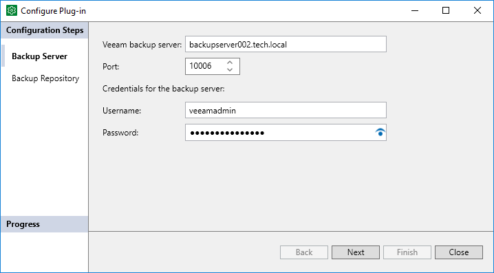

  1. At the Backup Server step of the wizard, specify settings to connect to the Veeam Backup & Replication server:
  1. In the Veeam backup server field, specify a DNS name of the Veeam Backup & Replication server.
  2. In the Port field, specify the port number over which Veeam Plug-In for Microsoft SQL Server will communicate with Veeam Backup & Replication. By default, Veeam Plug-In for Microsoft SQL Server uses port 10006.
For details about other required ports, see Ports.
  1. In the Username and Password fields, specify credentials that will be used to connect to the Veeam Backup & Replication server.
Configuring Veeam Plug-In for Microsoft SQL Server
  1. If you connect to the specified Veeam Backup & Replication server for the first time, Veeam Plug-In displays the Certificate Security Alert window. After you review the certificate, click Continue to confirm the connection.

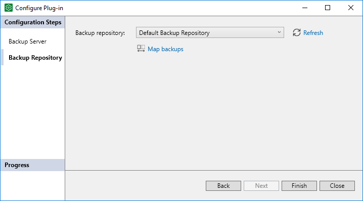

  1. At the Backup Repository step of the wizard, do the following:
  1. From the Backup repository drop-down list, select the required repository.
You can click Refresh to update the list of backup repositories. This may be helpful, for example, after you configure access to a backup repository and want to select this repository without the need to re-run the Configure Plug-In wizard.
  1. You can map Veeam Plug-In for Microsoft SQL Server backup jobs to backups stored in the backup repository. Backup job mapping can be helpful if you moved backup files to a new backup repository and want to point backup jobs to existing backups in this new backup repository. You can also use backup job mapping if the configuration database got corrupted and you need to reconfigure backup jobs.
To map Veeam Plug-In for Microsoft SQL Server backup jobs to backups in the backup repository, click the Map backups link and select one or more backups in the Select Backups window.
You can map Veeam Plug-In for Microsoft SQL Server backup jobs to multiple backups in the backup repository. This may be helpful, for example, if you want to continue a backup chain for databases that operate as part of a failover cluster or availability group.
  1. Click Finish to exit the wizard.
