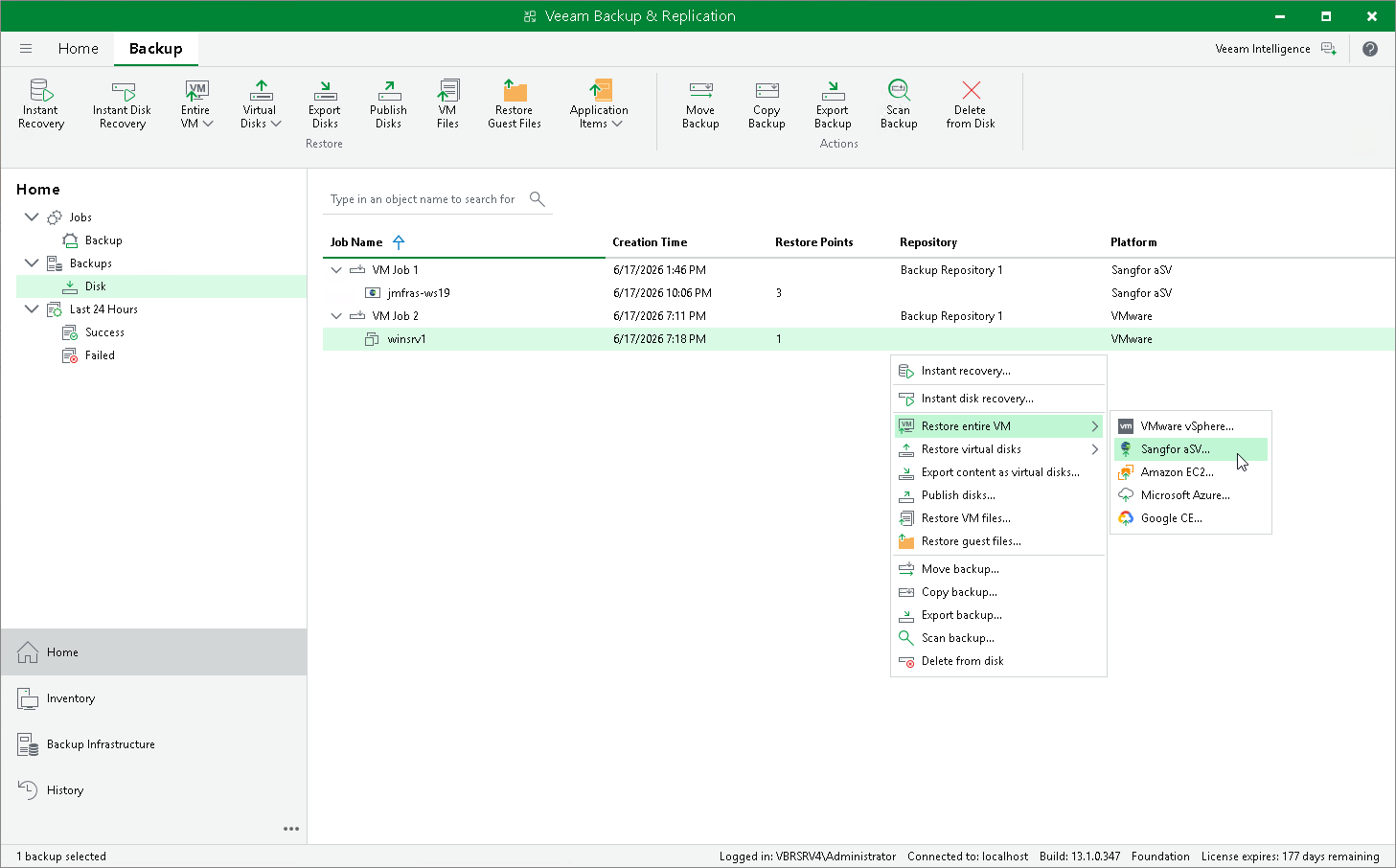

Step 1. Launch Entire VM Restore Wizard
To launch the Entire VM Restore wizard, do the following:
  1. In the working area, expand the necessary backup job, right-click the VM you want to restore and select Restore entire VM > Sangfor aSV.
Alternatively, expand the necessary backup job, select the VM and click Entire VM > Sangfor aSV on the ribbon.
