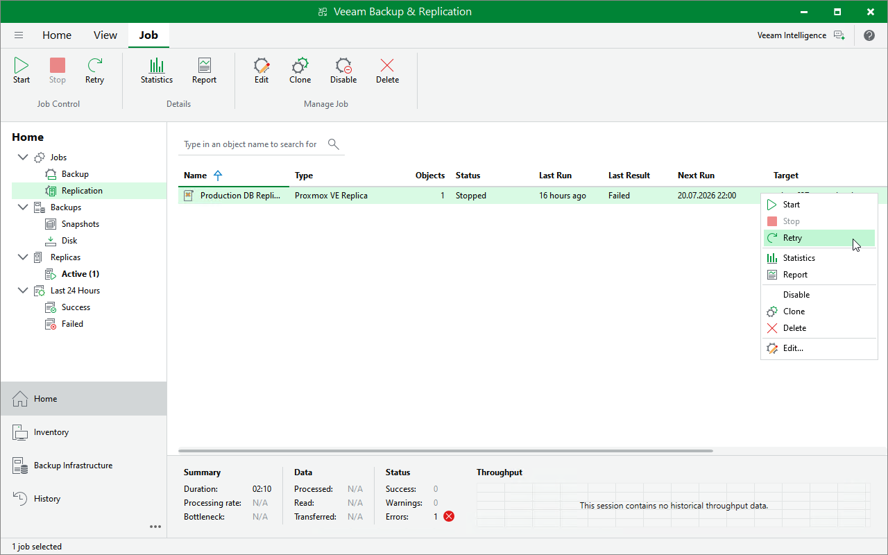

To retry a job, do the following:
  1. Open the Home view.
  3. In the working area, right-click the necessary job and select Retry.
Alternatively, select the job and click Retry on the ribbon.
Retrying Replication Job
