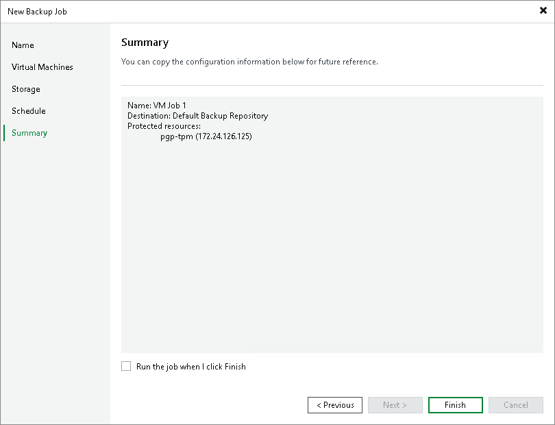

At the Summary step of the wizard, review summary information and click Finish. As soon as Veeam Plug-in for Scale Computing HyperCore starts the job, the backup progress will be displayed in the working area when you navigate to Jobs > Backup in the inventory pane of the Home view.
If you want to start the job immediately, select the Run the job when I click Finish check box and then click Finish.
