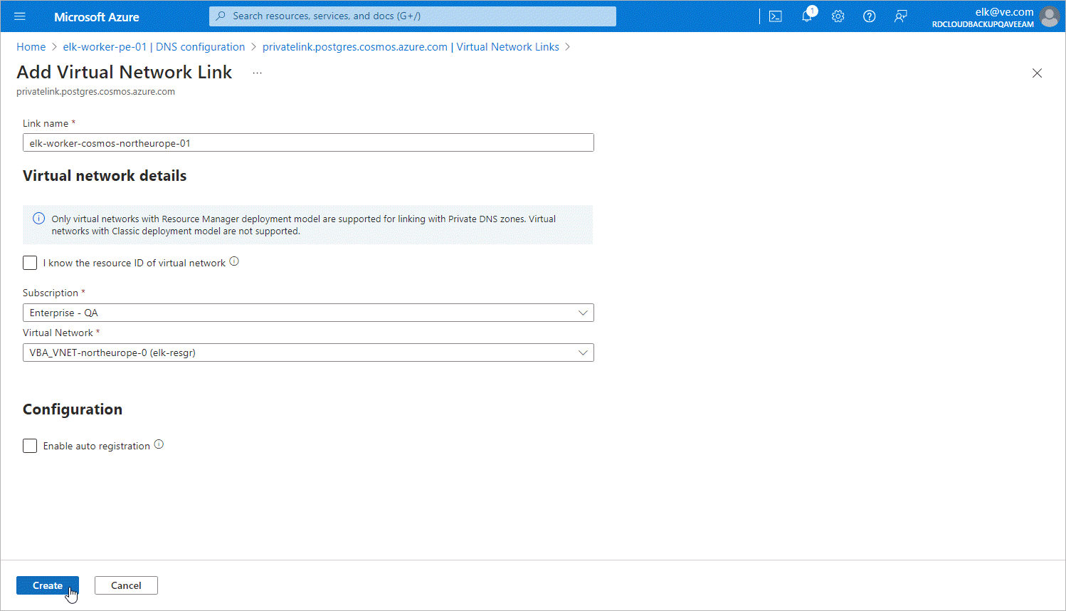

  3. In the Private DNS zone window, navigate to DNS Management > Virtual network links and click Add.
  4. In the Add virtual network link window, add to the DNS zone links to VNets to which the worker instances are connected. To do that, perform the following steps for each VNet link:
  1. In the Link name field, specify a name for the link.
  2. From the Subscription drop-down list, select the subscription where the VNet resides.
  3. From the Virtual network drop-down list, select the name of the VNet.
  4. Click OK.
  1. In the Virtual network links window, make sure that you have added links to all the necessary VNets.
