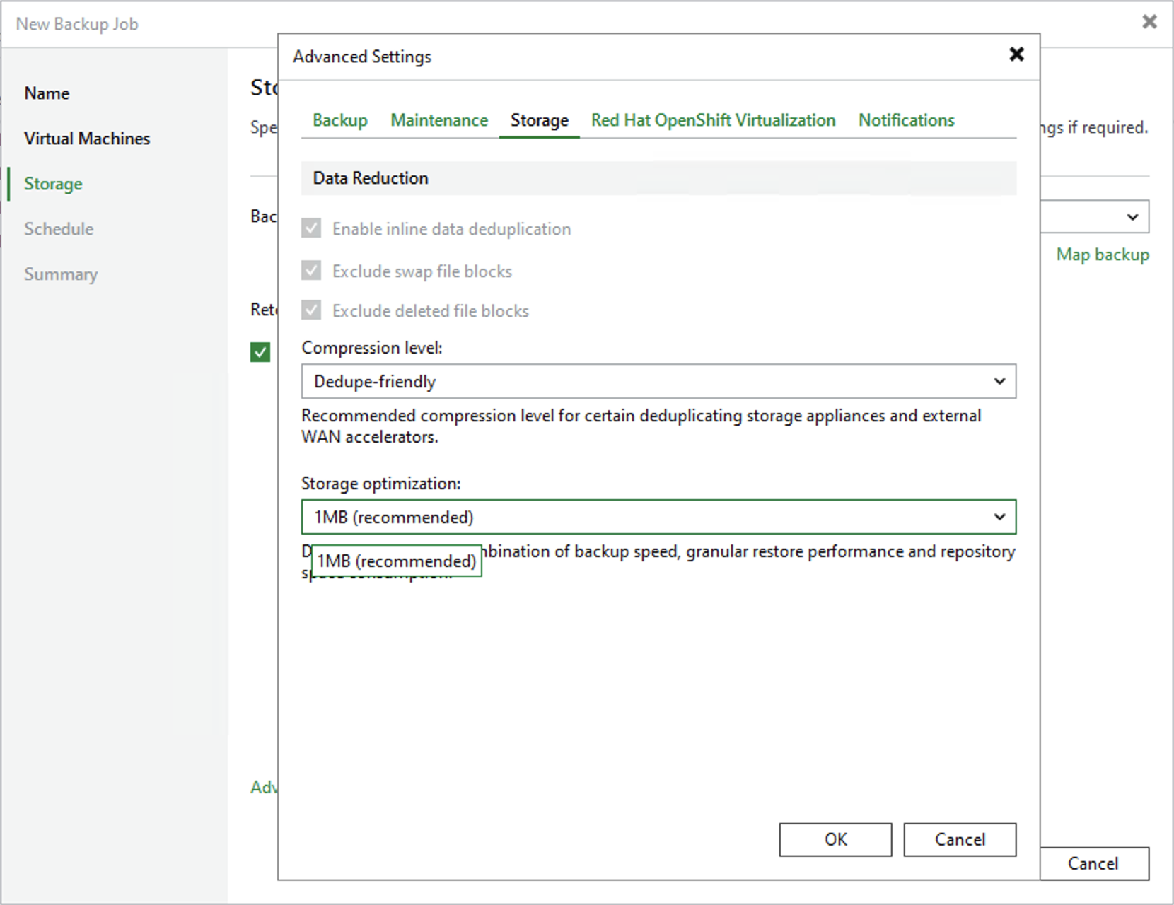

To specify storage settings for backup files created by the backup job, switch to the Storage tab and do the following:
  1. To decrease the size of the files, select a compression level from the Compression level drop-down list (None, Dedupe-friendly, Optimal, High or Extreme). For more information on data compression, see Compression and Deduplication.
  2. To optimize job performance and storage usage, select a block size from the Storage optimization drop-down list. Veeam Backup & Replication will use this size to "split" VM images into separate data blocks when processing VMs — the more data blocks there are, the more time is required to process the VM images. For more information on how data block sizes affect performance, see section Storage Optimization.
By default, Veeam Backup & Replication enables deduplication for backed-up data. Due to technical limitations, you cannot disable it while configuring backup jobs.
