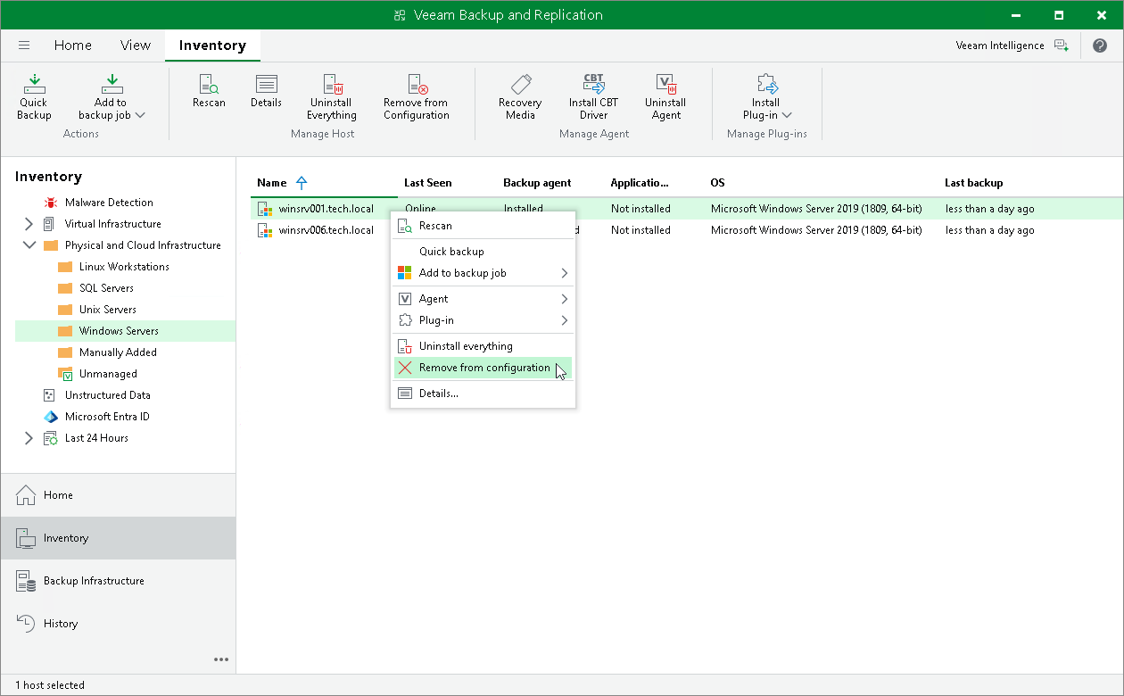

To remove a computer from a protection group in the Veeam Backup & Replication console:
  1. Open the Inventory view.
  2. In the inventory pane, expand the Physical and Cloud Infrastructure node and select the necessary protection group.
  3. In the working area, select the necessary computer and click Remove from Configuration on the ribbon or right-click the computer and select Remove from configuration.

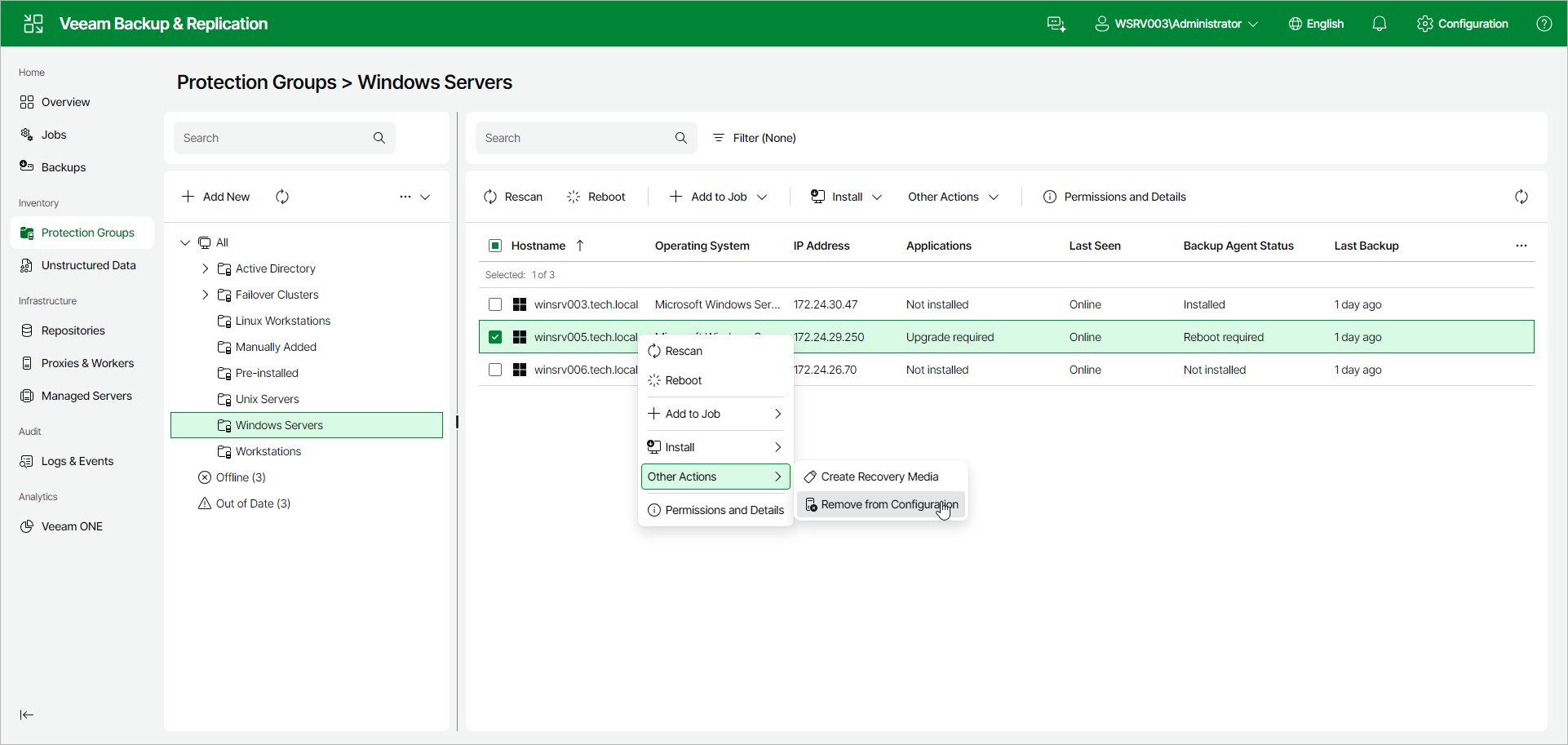

To remove a computer from a protection group in the Veeam Backup & Replication web UI:
  1. In the management pane, click Protection Groups.
  2. Select the protection group that contains the necessary computer.
  3. In the working area, select the check box next to the computers and click Other Actions > Remove from Configuration on the toolbar. Alternatively, right-click the computer and select Other Actions > Remove from Configuration.
