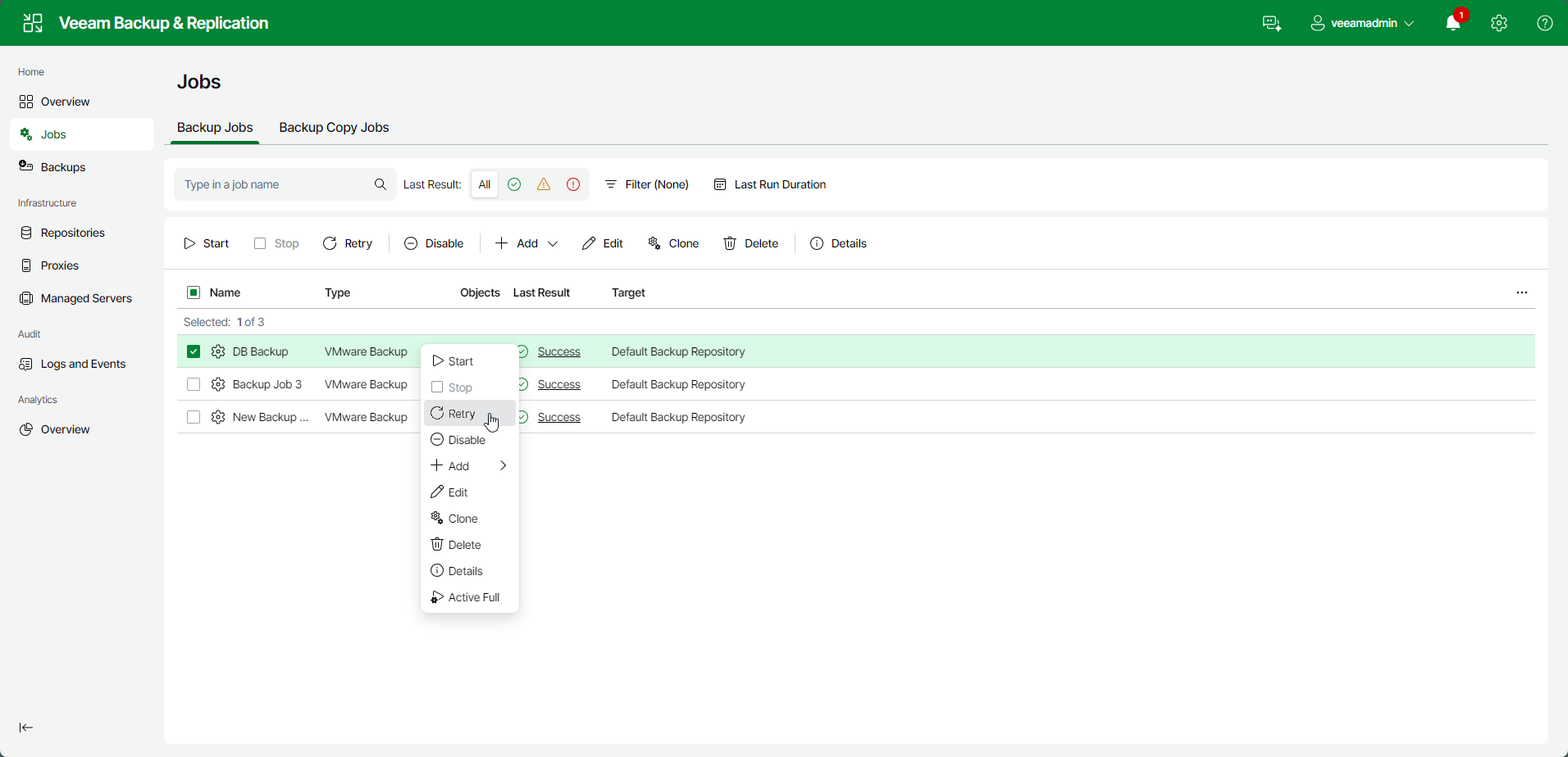

To perform retry for all workloads in a backup job:
- Open Jobs node in the management pane.
- In the working area, select the necessary job and click Retry on the ribbon. Alternatively, you can right-click the job and select Retry.
