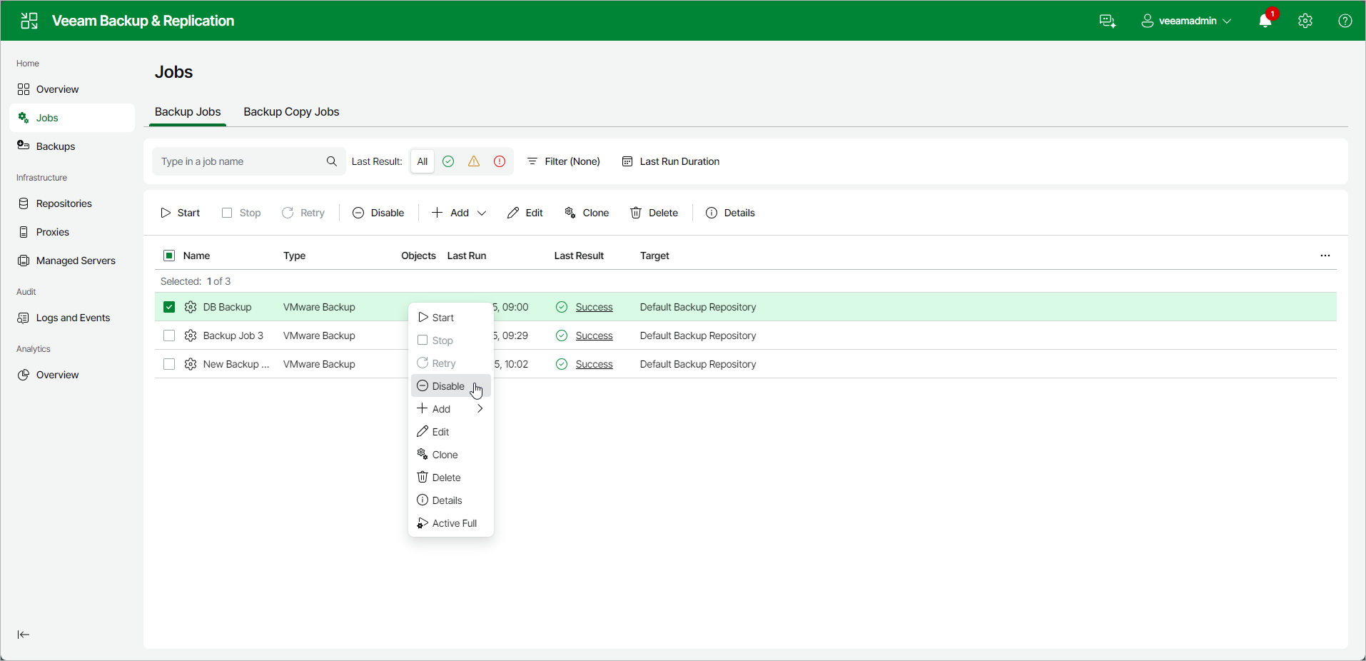

Disabling Jobs
To disable a job:
  1. In the management pane, click the Jobs node.
  2. In the working area, select a job and click Manage > Disable on the ribbon or right-click the job and select Manage > Disable.
To enable a disabled job, select it in the list and click Enable on the ribbon.
If the health check is enabled in the job settings, it will continue to run according to its own schedule, regardless of the job status.

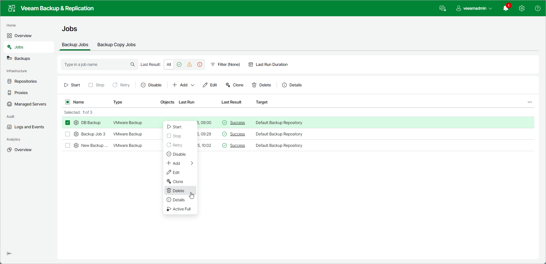

Deleting Jobs
To delete a job:
  2. In the working area, select a job and click Manage > Delete on the ribbon or right-click the job and select Manage > Delete.
After you delete a job, the backups created by this job are displayed in the Backups node. Their backup type is changes to Orphaned.
