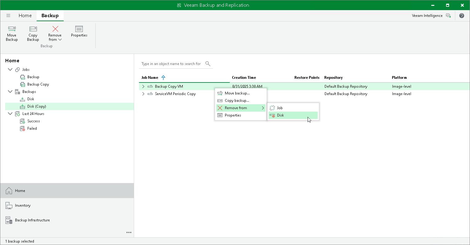

Deleting from Disk
When you use the Delete from disk option, you delete records about backup copies from the Veeam Backup & Replication console and configuration database, and delete backup files from the target backup repository. This option can be used for the whole backup copy or for some workloads in the backup copy.
For scale-out backup repositories, the Delete from disk operation removes backups from all tiers: performance, capacity and archive. This also applies to detached backups displayed in the node with the (Orphaned) postfix. If you want to remove backups from the performance tier only, move these backups to the capacity tier instead. For details, see Manually Moving Backups to Capacity Tier.
To permanently remove backup copies from the target backup repository:
  1. Open the Home view.
  2. In the inventory pane, select Backups > Disk (Copy).
  3. In the working area, right-click the backup copy job or a workload in the backup copy and click Remove from > Disk.
  4. To remove all weekly, monthly, quarterly and yearly backups from disk, select the Remove GFS full backups check box and click Yes.

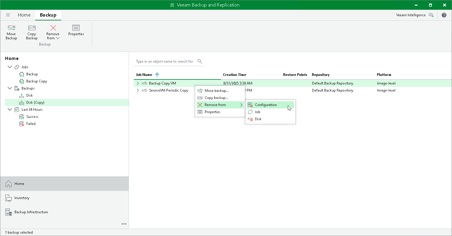

Removing Backups from Configuration
Removing backups from configuration is designed for experienced users only. Consider using Detach from job or Delete from disk operations.
Create encrypted configuration backup before removing backups from configuration.
When you remove a backup from the configuration, backup files remain in the backup repository. You can import the backup to Veeam Backup & Replication at any time later and restore data from it.
When you remove an encrypted backup from configuration, Veeam Backup & Replication removes encryption keys from the configuration database. If you import such backup on the same backup server or another backup server, you will have to specify the password or unlock the backup with Veeam Backup Enterprise Manager. For more information, see Importing Encrypted Backups.
To remove a backup from the configuration:
  3. In the working area, press the [Ctrl] key, right-click the backup that you want to remove and select Remove from > Configuration.
