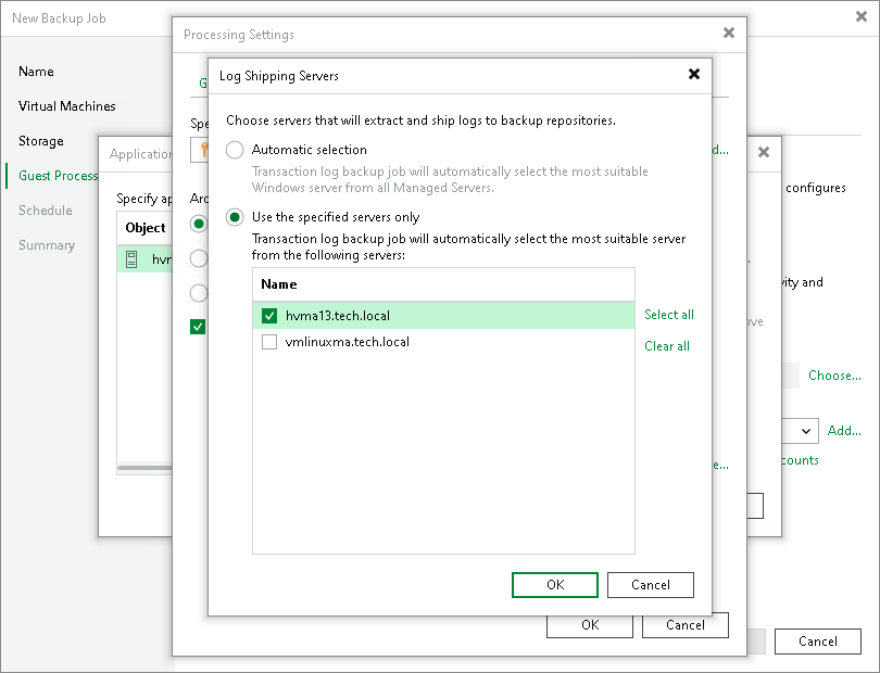

  • Over log shipping server. If a direct connection is not possible, files will be shipped through log shipping servers. You can configure Veeam Backup & Replication to choose a log shipping server from the list of available ones or to use a specific server. Log shipping servers transfer data over the network. That is why you should check that server are available over the network.

A log shipping server is a Microsoft Windows or Linux server added to the backup infrastructure. You can also assign the log shipping server role to a machine deployed with Veeam Software Appliance or Veeam Infrastructure Appliance. You can explicitly define what servers you want to use for log shipping or instruct Veeam Backup & Replication to automatically choose an optimal log shipping server. Veeam Backup & Replication chooses the log shipping server based on two criteria: possible data transfer methods and location of the PostgreSQL VM and log shipping server. For more information, see Location of Log Shipping Server and VMs.

If you do not want to use some servers for WAL files transport, you can manually define what server Veeam Backup & Replication must use as a log shipping server in the job settings. It is recommended that you assign the log shipping server role to a number of servers for availability purposes.
