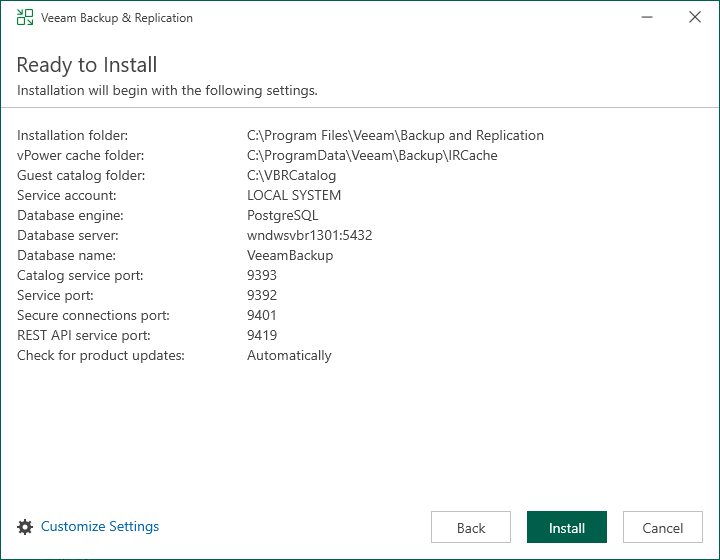

Step 6. Review Default Installation Settings
At the Ready to Install step of the wizard, you can select to install Veeam Backup & Replication with default installation settings or specify custom installation settings.
  • To use the default installation settings, click Install.
  • To use custom installation settings, click Customize Settings. The setup wizard will include additional steps that will let you configure installation settings.
The following table lists the default installation settings.
Setting
Default Value
Description
Installation folder
C:\Program Files\Veeam\Backup and Replication\
Folder where Veeam Backup & Replication will be installed.
vPower cache folder
C:\ProgramData\Veeam\Backup\IRCache\
The IRCache folder on a volume with the maximum amount of free space. The IR cache folder stores the write cache for machines that are started from backups during recovery verification or restore operations. The minimum required free disk space for the IRCache folder is 10 GB. However, at least 100 GB is recommended for production environments, and more may be needed depending on the number and write activity of VMs being published with Instant Recovery.
Guest catalog folder
C:\VBRCatalog\
The VBRCatalog folder on a volume with the maximum amount of free space.
The guest catalog folder stores indexing data for VM guest OS files. Indexing data is required for browsing and searching for VM guest OS files inside backups and performing 1-click restore.
Service account
LOCAL SYSTEM
Account under which the Veeam Backup Service runs.
Database engine
PostgreSQL
The setup wizard installs PostgreSQL as a database engine locally on the Veeam Backup & Replication server.
SQL server
<host_name>:5432
The local host name and port number to be used by SQL server.
Database name
VeeamBackup
The setup deploys the Veeam Backup & Replication configuration database on the locally installed instance of PostgreSQL.
Catalog service port
9393
The catalog service port is used by the Veeam Guest Catalog Service to replicate catalog data from backup servers to Veeam Backup Enterprise Manager.
Service port
9392
The service port is used by Veeam Backup Enterprise Manager to collect data from backup servers. In addition to it, the Veeam Backup & Replication console uses this service port to connect to the backup server.
Secure connections port
9401
The secure connections port is used by the mount server to communicate with the backup server.
REST API service port
9419
This service port is used to access the Veeam Backup & Replication REST API.
Check for updates
Automatically
Veeam Backup & Replication will check for product updates weekly. When a new product build is published on the Veeam update server, a notification is displayed in the Windows Action Center.
