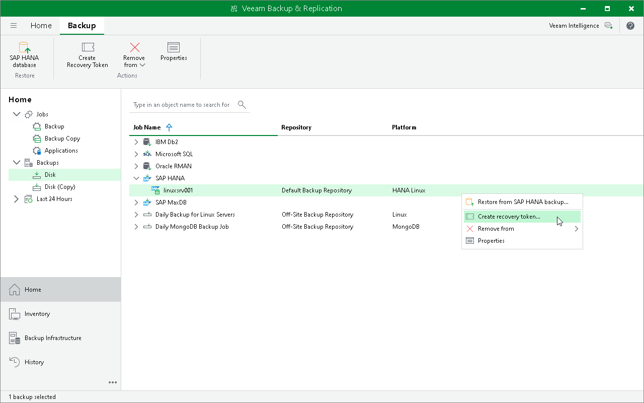

Creating Recovery Token
If you want to recover a database from a specific backup, you can use the Create recovery token operation.
You can generate a recovery token on the Veeam Backup & Replication side. Then, on the SAP HANA server side, use this token to get access to the backup and recover the database stored in it. To learn more about operations on the SAP HANA server side, see Restore to Another Server.
Before creating a recovery token, consider the following prerequisites and limitations:
  • Recovery tokens stay valid for 24 hours.
  • You can recover data only from the backup for which the recovery token is generated.
  • During recovery, Veeam Backup & Replication does not stop backup operations.
  • You cannot create a recovery token for a whole backup copy job, but you can create a recovery token for individual objects included in a backup copy job.
To create a recovery token on the Veeam Backup & Replication side:
  1. Open the Home view.
  2. In the inventory pane, click Backups.
  3. In the working area, right-click the backup and select Create recovery token.
You can create a recovery token for several backups. To do this, press and hold [Ctrl], select multiple backups, right-click one of the selected backups and select Create recovery token.
  1. In the Create Recovery Token window, click Create.
Alternatively, you can create and modify the existing recovery token using the PowerShell console. To learn more, see the Working with Tokens section in the Veeam PowerShell Reference.

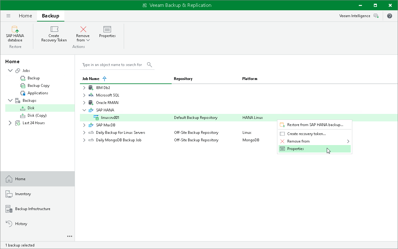

Viewing Backup Properties
To review what data Veeam Plug-In has backed up, check the backup properties in the Veeam Backup & Replication console.
To view backup properties:
  2. In the inventory pane, expand the Backups node and select Disk. To view properties of backups stored on tape, select Tape.
  3. In the working area, right-click the backup and select Properties.
The backup properties window displays the following information about the content of a backup file:
  • Objects — databases backed up by Veeam Plug-In.
  • Files — backup files of a selected database that are stored in the backup repository.
To find a specific item in a list, use the search field. To copy the path to a backup file, use the Copy path button.
