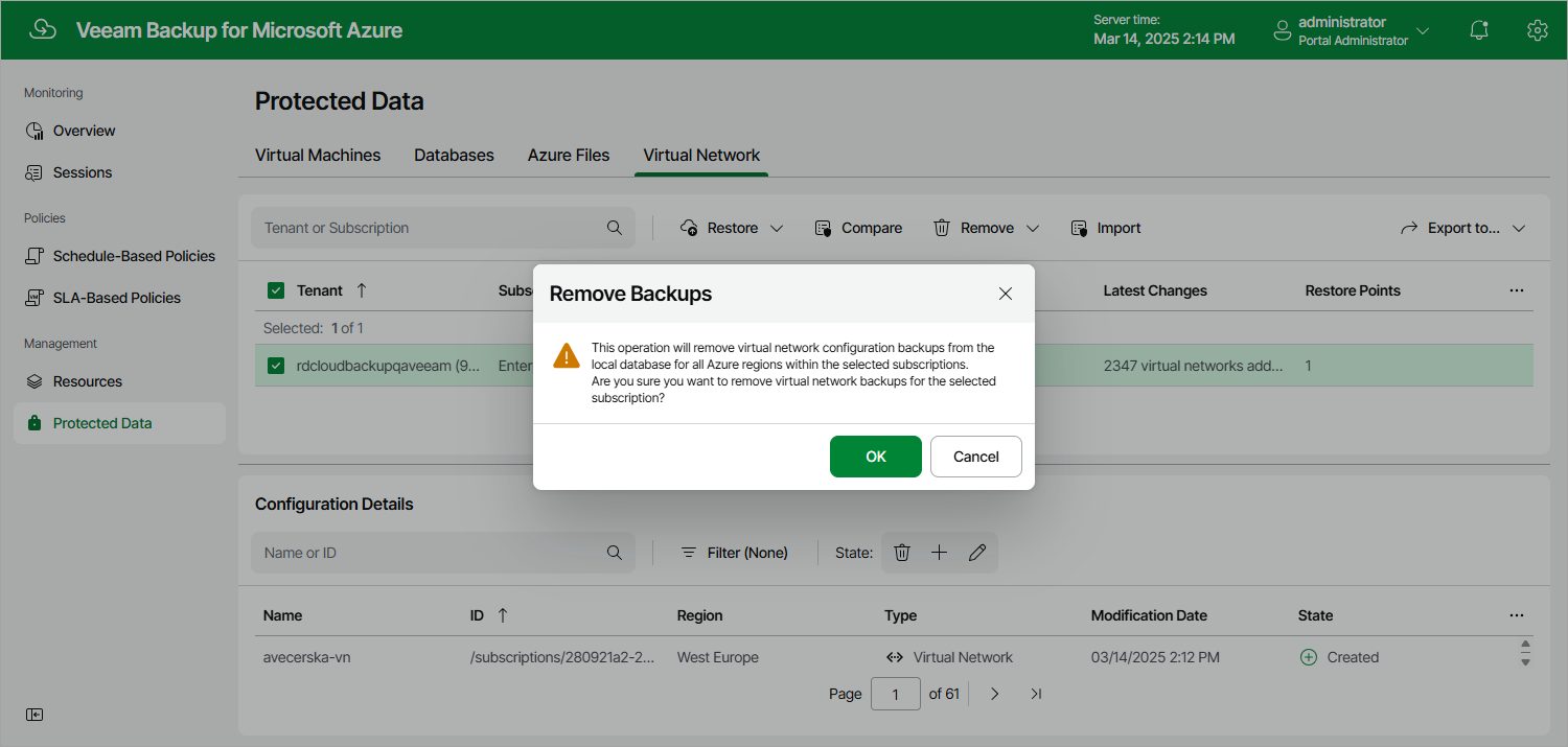

To remove backed-up data manually, do the following:
  1. Navigate to Protected Data > Virtual Network.
  2. Select the configuration record for which you want to remove the backed-up data.
Each configuration record contains a whole set of all virtual network configuration backups created for an Azure subscription. Note that you cannot remove individual virtual network configuration items or specific backups.
  1. Click Remove and select one of the following options:
  • Backups — to remove all virtual network configuration backups for the selected configuration record from the backup appliance database.
  • Backup Copies — to remove all virtual network configuration backups of an Azure subscription from all repositories.
  • All — to remove all virtual network configuration backups for the selected configuration record.
