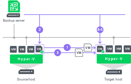

When you start the planned failover, Veeam Backup & Replication performs the following operations:
  1. The failover process triggers the replication job to perform an incremental replication run and copy the un-replicated changes to the replica.
  2. The VM is powered off.
  3. The failover process triggers the replication job to perform another incremental replication run and copy the portion of last-minute changes to the replica. The replica becomes fully synchronized with the source VM.
  4. The VM is failed over to its replica.
  5. The VM replica is powered on.
During the planned failover, Veeam Backup & Replication creates two helper restore points (steps 1 and 3) that are not deleted afterwards. You can see these restore points in the list of restore points for the VM. You can use the restore points later to roll back to the necessary VM replica state.
