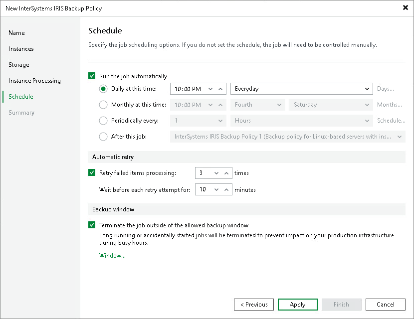

Step 7. Specify Policy Schedule
On the Schedule step of the wizard, specify the job scheduling options. If you do not set a schedule, the job will need to be controlled manually.
To specify the policy schedule:
  1. Select the Run the job automatically check box. If this check box is not selected, you will have to start the backup policy manually to create a backup.
  2. Define scheduling settings for the policy:
  • To run the policy at a specific time daily, on defined week days or with specific periodicity, select Daily at this time. Use the fields on the right to configure the necessary schedule.
  • To run the policy once a month on specific days, select Monthly at this time. Use the fields on the right to configure the necessary schedule.
  • To run the policy repeatedly throughout a day with a specific time interval, select Periodically every. In the field on the right, select the necessary time unit: Hours or Minutes.
  • To define the permitted time window for the policy, click Schedule and use the time table. In the Start time within an hour field, specify the exact time when the policy must start.

  1. In the Automatic retry section, define whether Veeam Backup & Replication must attempt to run the backup policy again if the policy fails for some reason. Enter the number of attempts to run the policy and define time intervals between them.
  2. In the Backup window section, define the time interval within which the backup policy must complete. The backup window prevents the policy from overlapping with production hours and ensures that the policy does not impact the performance of your server. To set up a backup window for the policy:
  1. Select the Terminate job if it exceeds allowed backup window check box and click Window.
  2. In the Time Periods window, define the allowed hours and prohibited hours for backup. If the policy exceeds the allowed window, it will be automatically terminated.
NOTE
If you configure a backup policy, after you click Apply at the Schedule step of the wizard, Veeam Backup & Replication will immediately apply the backup policy to the protected InterSystems IRIS instances.
